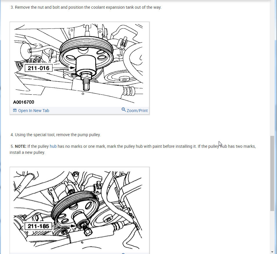

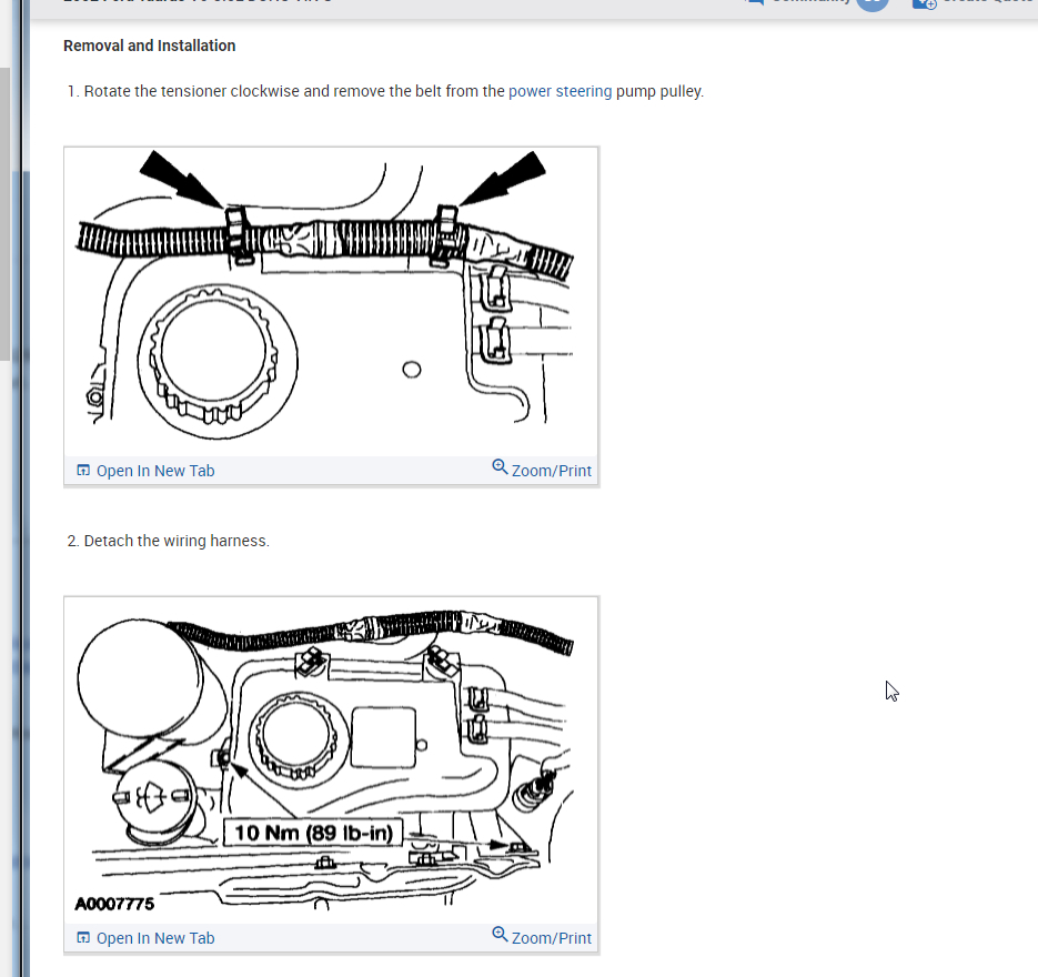

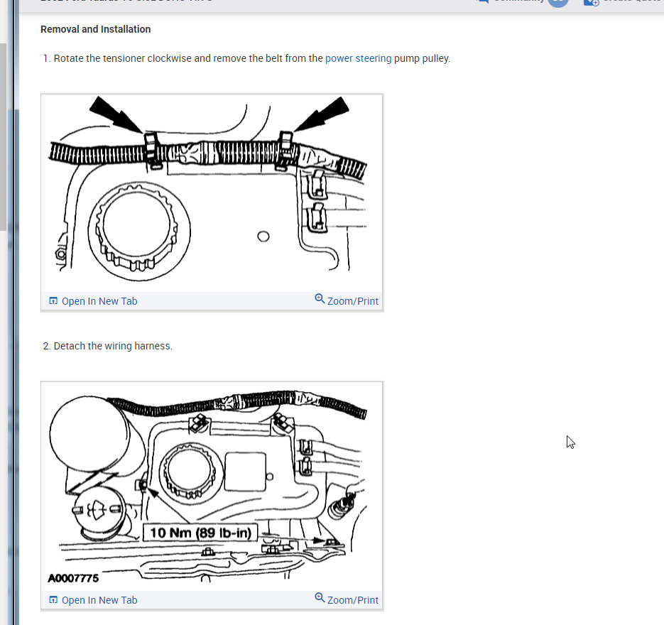

Hi i`ve notticed that the power steering fluid is gushing out of the pump and also leaking under the engine i thought it was engine oil but i looks like power steering fluid also it makes a noise when i turn and its been kind of hard to turn. please help me figure this out thanks,will
Mar 6, 2009 at 5:57 PM
Here are some guides that will help with this:
https://youtu.be/C1h8Xl1E8hI
https://www.2carpros.com/articles/how-to-replace-a-power-steering-pump
Below you will find the process from the manual that will help get this replaced. Noise when you turn is most always a pump issue so let us know how you make out with this. Thanks
