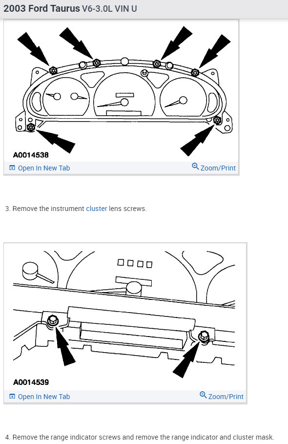

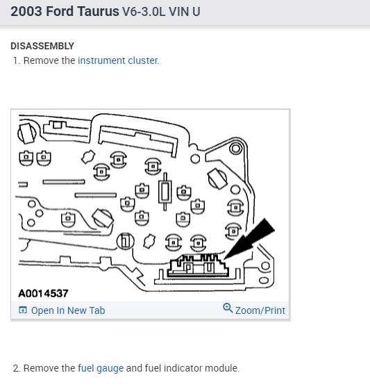

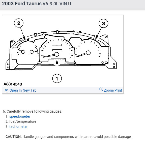

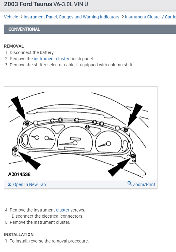

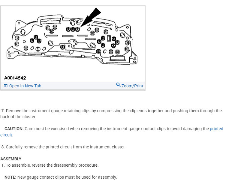

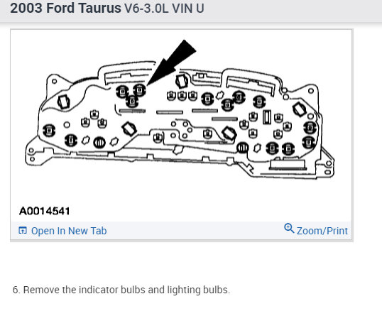

how to get the instrument panel off?
Oct 4, 2009 at 11:19 AM
SQM
  • 6,383 POSTS
The instrument cluster on this vehicle can be removed quite easily.
Frist you will have to remove the plastic trim around the gauge cluster. This panel pops off. This will expose the mounting screws for the cluster.
Simply remove those screws to take the cluster out.
