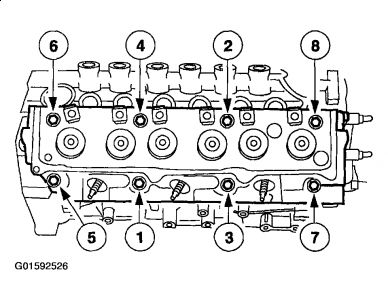

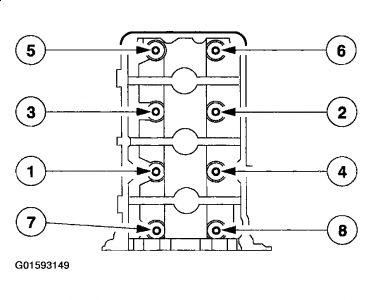

2003 Ford Taurus HEAD GASKET TORQUE?
2003 FORD TAURUS
140,000 MILES • 6 CYL • FWD • AUTOMATIC
PROVAMP27577
NEED TO KNOW THE TORQUE FOR THE HEAD GASKETS ONCE THEY HAVE BEEN REPLACED.
Mar 5, 2010 at 4:40 AM
2CARPRO JACK
  • 11,533 POSTS
For the 2 valve engine the sequence is as follows tighten to 37 inch lbs loosen 1 full turn tighten to 22 ft lbs tighten 90 degrees tighten another 90 degrees in this order

For the 4 Valve Tighten to 30 Ft lbs tighten to 66 t lbs loosen 1 turn tighten to 30 ft lbs tighten 90 degrees tighten another 90 degrees in this order
