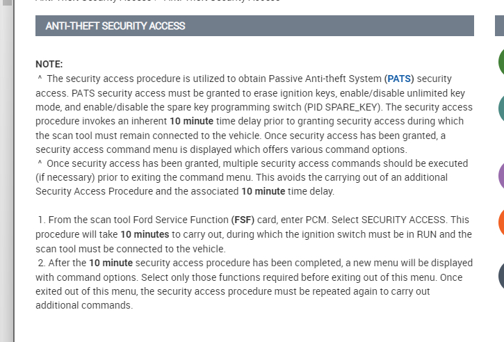

My theft light is blinking and the auto start is not working with the remote.
Feb 12, 2010 at 10:19 AM
The remote start will not work until the theft light issue is solved.
So, this could be as simple as disarming the system or there could be an issue with it that we need to figure out. Here is a guide that will help get us started:
https://www.2carpros.com/articles/how-to-reset-a-security-system
We should start with checking for codes and finding out if there are any if disarming the system does not work.

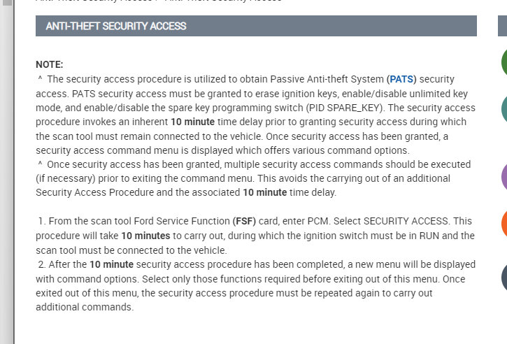

I am then attaching the process from the manual to help access the system but if there are codes then we need to address those first.
Please run through all this material and let me know what questions you have, and we can go from there. Thanks
