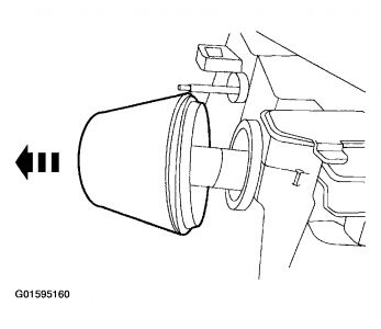

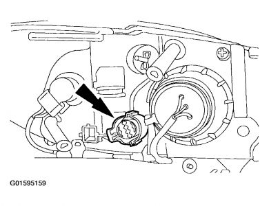

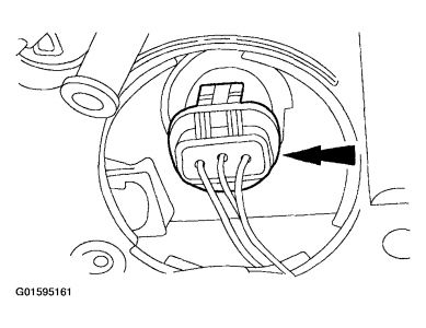

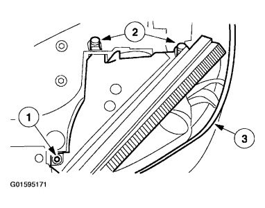

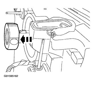

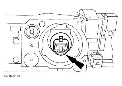

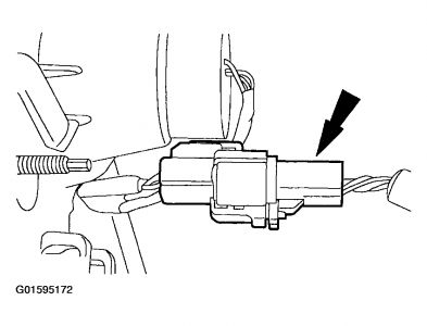

I am trying to figure out how to change my head lamps. How do I change my passenger side head lamp?

Remove the headlamp assembly.
* Remove the bolt.
* Remove the retaining rods.Remove the headlamp assembly.
https://www.2carpros.com/forum/automotive_pictures/55316_03taurusheadlight2_1.jpg
Disconnect the headlamp assembly wiring harness.
https://www.2carpros.com/forum/automotive_pictures/55316_03taurusheadlight3_1.jpg
Disconnect the electrical harness from the headlamp bulb cover.
https://www.2carpros.com/forum/automotive_pictures/55316_03taurusheadlight4_1.jpg
Rotate the headlamp bulb cover counterclockwise and remove the cover.
https://www.2carpros.com/forum/automotive_pictures/55316_03taurusheadlight5_1.jpg
Disconnect the headlamp bulb electrical connector.
https://www.2carpros.com/forum/automotive_pictures/55316_03taurusheadlight6_1.jpg
Rotate the headlamp bulb retaining ring counterclockwise and remove the ring.
https://www.2carpros.com/forum/automotive_pictures/55316_03taurusheadlight7_1.jpg
Remove the headlamp bulb.
To install, reverse the removal procedure.
