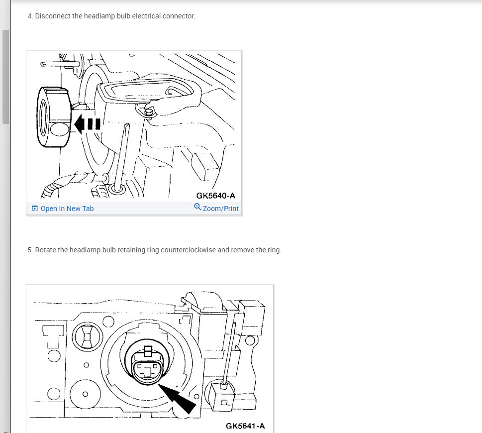

How do you remove the headlamp to replace the bulbs
Feb 14, 2009 at 8:11 AM

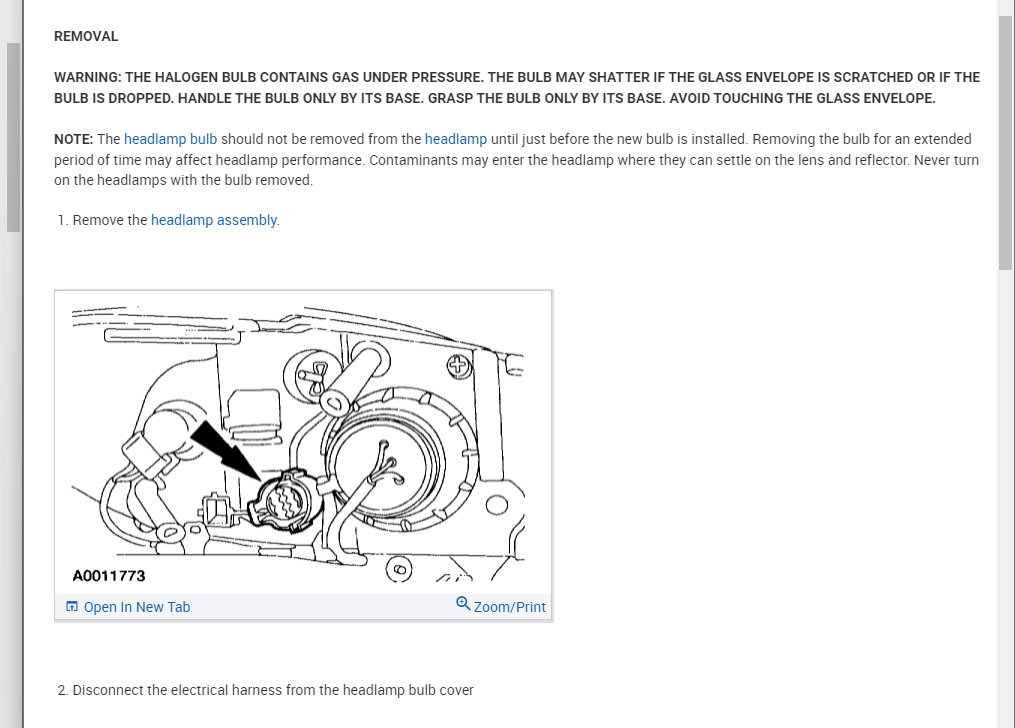

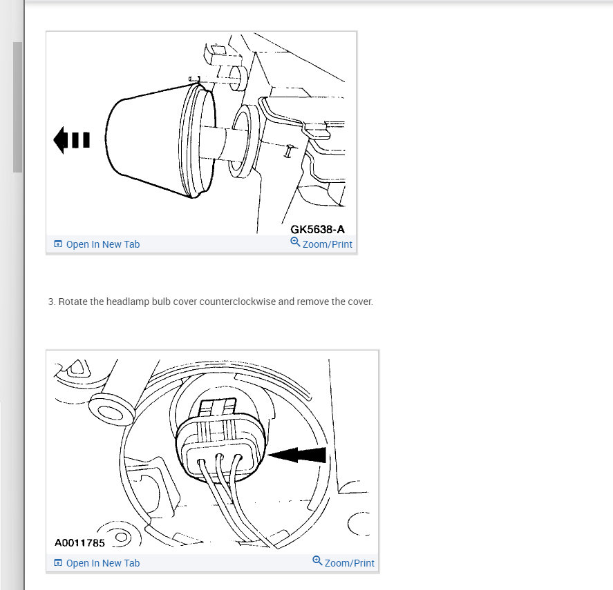

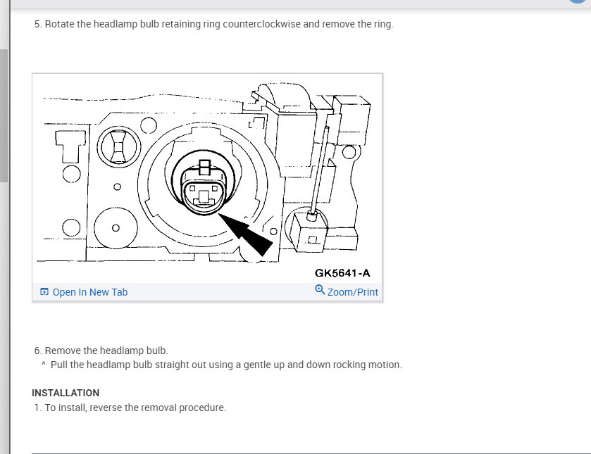

You can change this from under the hood and you will see an access point behind the assembly. Just follow the wiring harness in and that will lead you to the socket.
Here is a video that will help with this on a similar vehicle:
https://www.youtube.com/watch?v=LzdJeeeRvvs&t=327s
Below you will find the process from the manual that helps with replacing the bulb.
Please let me know if you have questions about this.
