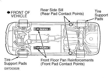

Where do you jack this car up from and do i have to use the car jack or can i use my floor jack. There is so many plastic parts under there it has got me leary on how to proceed. The car has rear traction control also can you point out where to jack from with a picture.

https://images.2carpros.com/forum/automotive_pictures/99387_Graphic1_678.jpg
