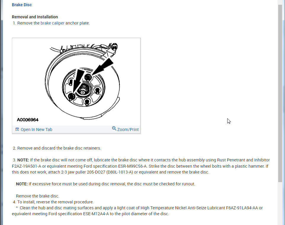

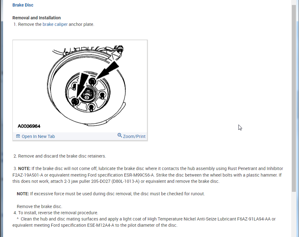

Steering wheel shakes when brakes are applied?
Friday, April 18th, 2008 AT 9:29 AM
MECHANIC
18,907 POSTS
This could be a number of things and here is guide that will help with this:
https://www.2carpros.com/articles/steering-wheel-shakes-when-accelerating-or-braking
However, the most likely cause is the front rotors are warped and need to be replaced.
Below you will find the process from the manual on how to replace the rotors. Please let us know if you have other questions. Thanks
