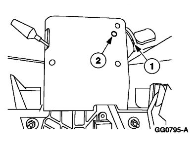

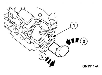

The open door light stays on even when all doors are closed and the automatic locks keep going on and off while driving and making the dome like come on and stay on, but when i open and close the passenger front door all is well again for a few mintiues. What could be the cause of this.
Dec 2, 2008 at 11:20 PM
BMRFIXIT
  • 19,053 POSTS
Door switch sticking use WD40 and spray them all(door latch) close and open door few times and spray again if that did not work you may have to use a scanner to check witch door switch is it and replace it good luck
