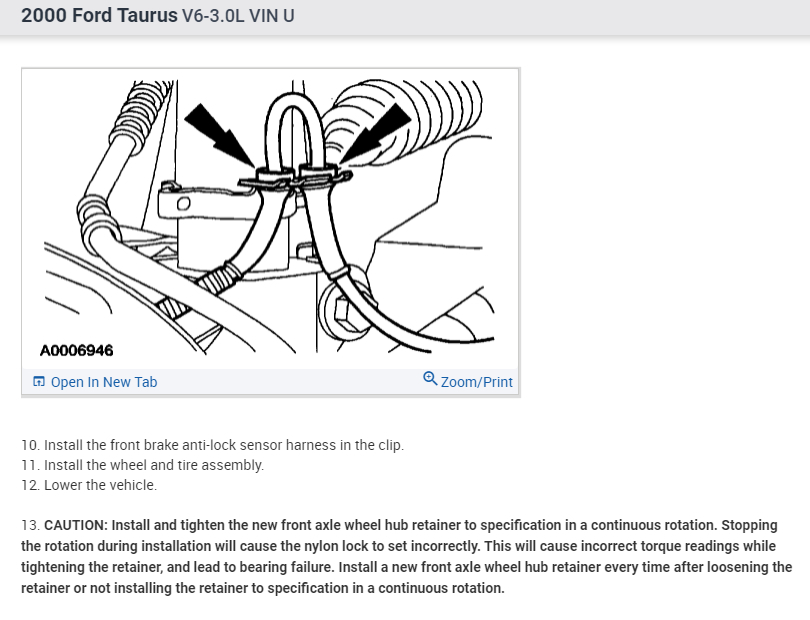

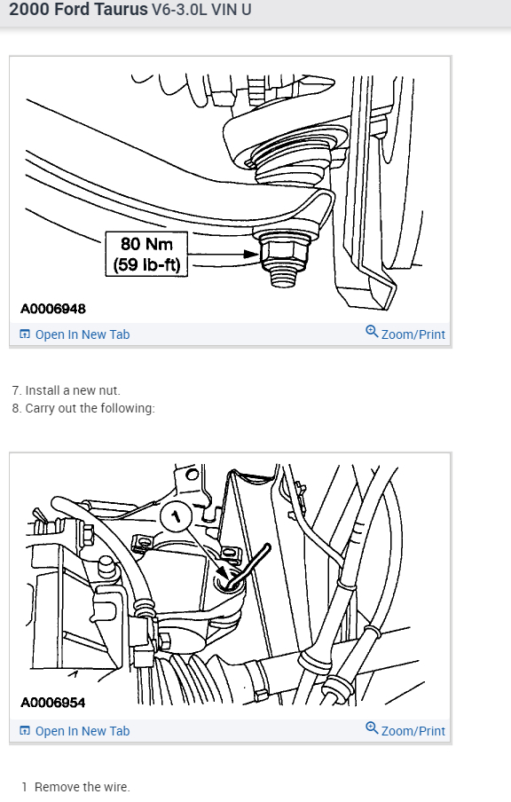

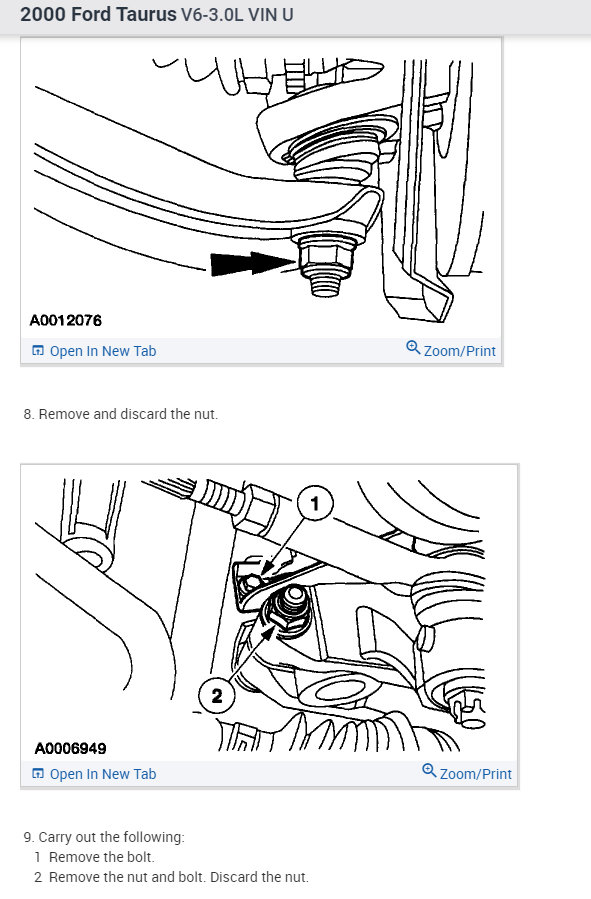

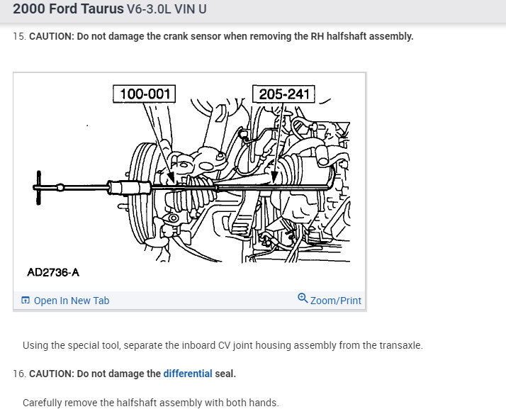

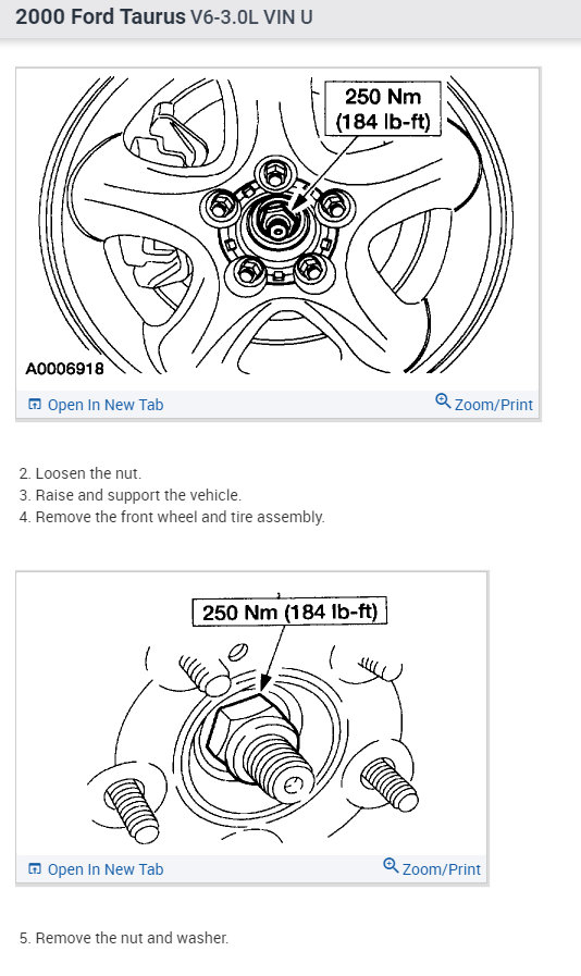

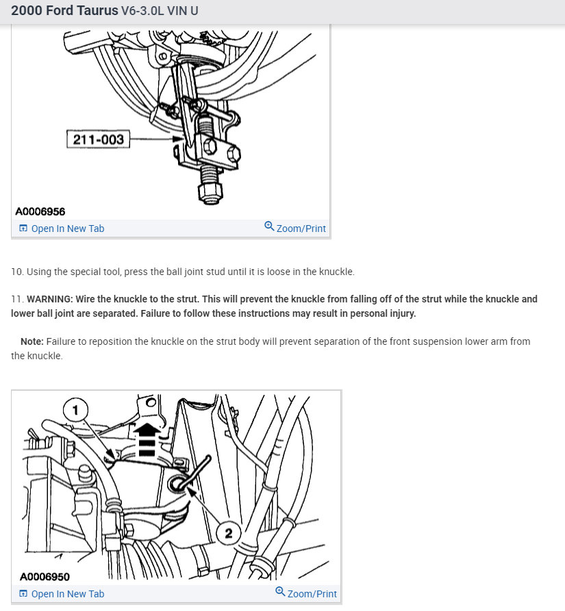

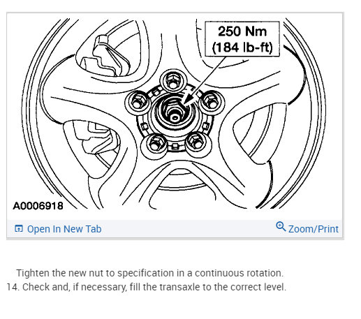

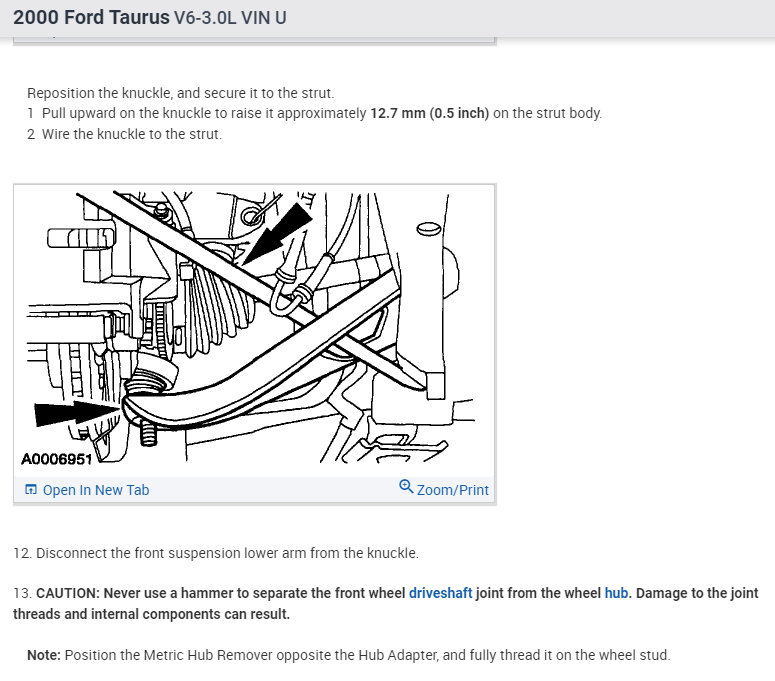

I replaced the front Rotars and brake pads last night. When the right front was off my husband found thick grease on the axle and saw that the boot was torn on the underside. How do you take the old CV Boot off and replace it? Is it something that the "Average Joe" mechanic can do or should only a certified mechanic attempt this?
Also, I cant find an online manual. Do you know of one?
How do I donate question next time?? I dont have a credit card.
Thanks :)
Snokio
Sep 11, 2008 at 3:32 PM
SQM
  • 6,383 POSTS

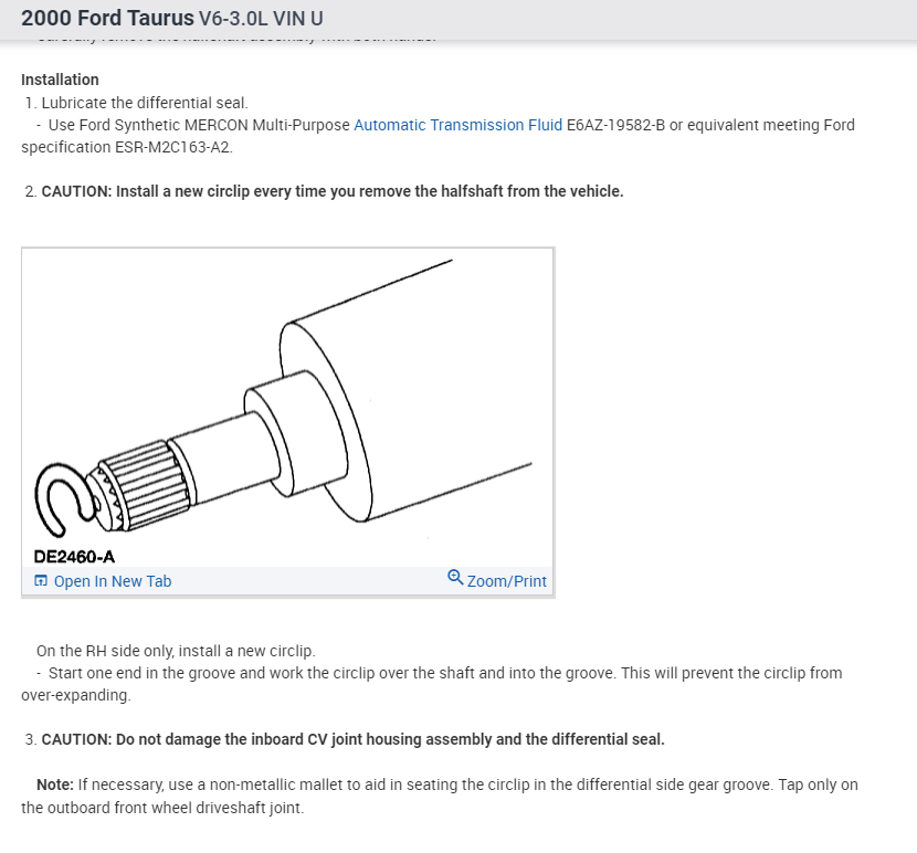

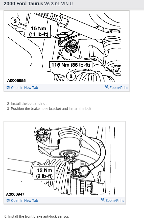

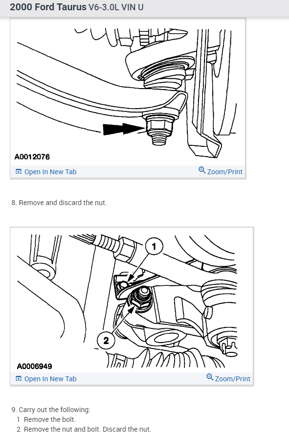

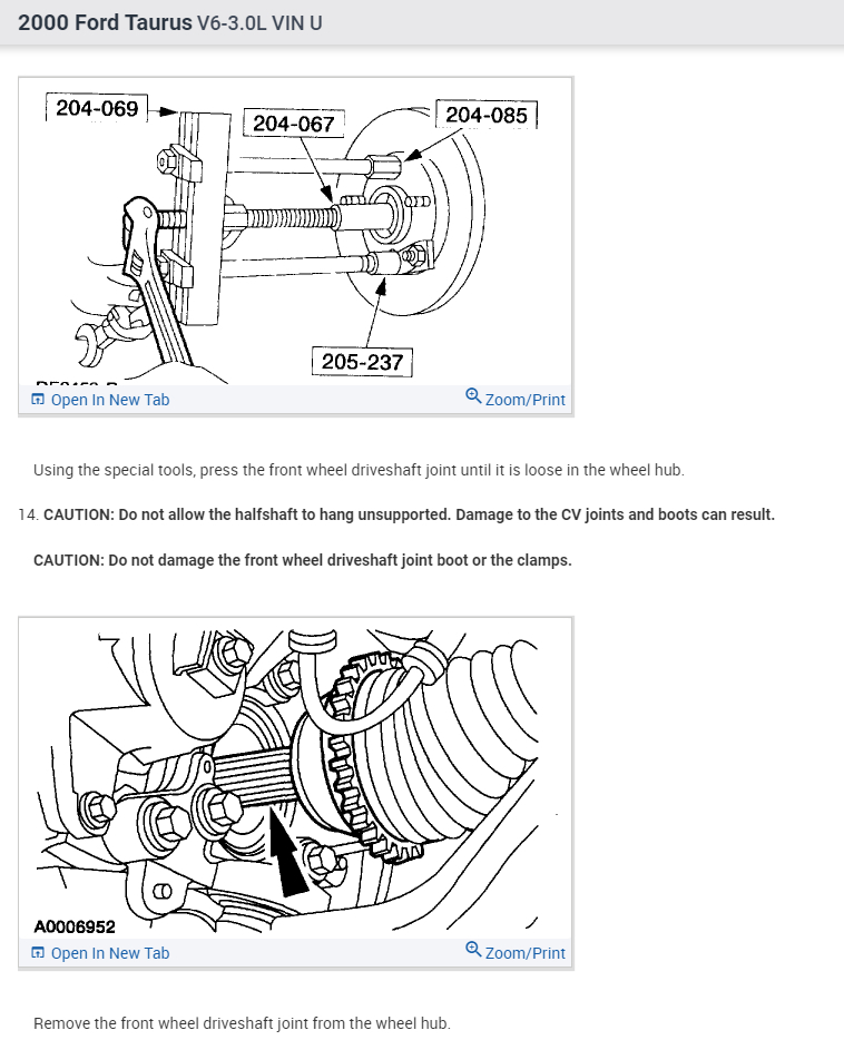

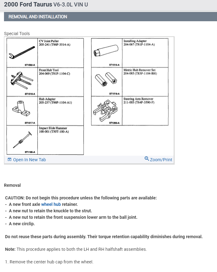

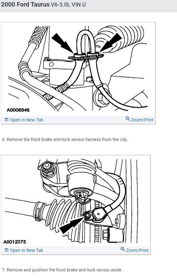

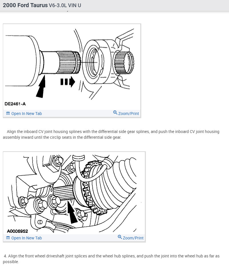

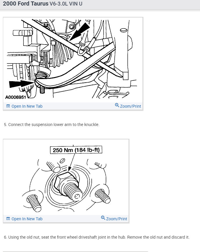

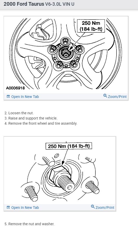

The CV boots can be replaced using simple tools and with little know how.
However, if the boot has been tor for a while and you are getting noises, it is likely has damaged CV joint and just replacing the boot will not fix the issue.
This will require replacement of the CV axle.
It will be a good idea to inspect the joint for any corrosion or weather damage.
Are you getting any noises while turning?
Here is a helpful guide:
https://www.2carpros.com/articles/replace-cv-axle
I have attached diagrams for CV shaft replacement below.
