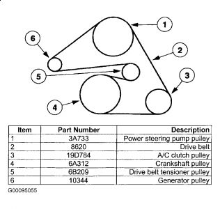

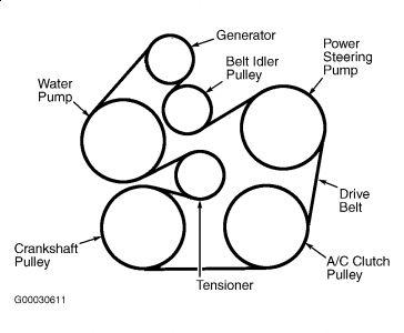

The compressor is going out. it looks like it will freeze up soon therefore taking out the belt. My question is: I can't spend the 1200 for a replacement compressor, therefore isn't there a way to just remove the compressor all together and put a new belt on or maybe a pully of some sort?
Thank you very much,
Howard
Mar 18, 2009 at 3:29 AM
BMRFIXIT
  • 19,053 POSTS
Some you can get away with a smaller belt and other you can not it will not work check which one you have The 1st one will not work the 2nd may work
