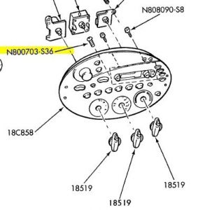

The blower switch is FRIED, locked up tight. How do I get the panel off the front of the dash so I can replace the switch?
Jan 21, 2010 at 8:06 PM
BLACKOP555
  • 10,386 POSTS
there should be two black holes on each side. insert a radio pulling tool in there and the dash should pop out

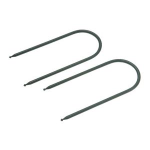

to remove radio you need special tools that look like this

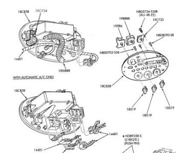

this is what the radio panel look like
https://images.2carpros.com/forum/automotive_pictures/99387_fan_27.jpg
https://images.2carpros.com/forum/automotive_pictures/99387_fan1_4.jpg
