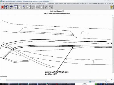

my heater/air con. blower does not work I have replaced the switch and it worked for a couple of days then quit One time the blower came on when I put the car in park Another time it came on when I hit a bump in the road. Now this sounds like a loose wire but how can I find the real problem?

There is a TSB on the Rain Hat! Open the hood and remove the plastic cowl on the passenger side, and follow these directions, parts list includes new blower and resistor...
