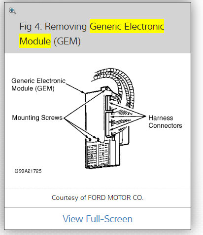

I have a 2002 Ford Taurus. the anti theft is malfunctioning. Most of the time I'm unable to start my car. And when I'm able to it sometimes it shuts down a few seconds after starting, and then it may be days before I can start it again. Or I end up being stranded somewhere. Is there a way that I can deactivate it?
Oct 31, 2018 at 4:44 AM (Merged)
  • 110,248 POSTS
It cant be bypassed it sounds like the GEM is out and needs to be replaced here is the location. Check out the diagrams (Below). Please let us know what happens.
