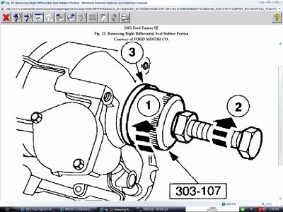

What a mess I got into. The patient is a 2001 Ford Taurus SES, 3.0L OHV, Ax4s Trans. It needed a hub bearing, inner cv and ball loint on passenger side. After some false starts on parts I got it taken down and was all set to reassemble. Probably not a long process at that point. Then I got really stupid. I had in my possession a replacement seal for the output shaft on the trans where the splines from the inner CV Joint go into the transmission. The old one seemed fine and dry but I thought it wasn't a bad idea to replace it. I had not gotten my on line access yet so I referenced the local Haynes Manual I have. Bad mistake. It described a very easy process to remove the old seal. Can't be done. At this point the old seal is wrecked from numerous removal attempts. Can't remove it. It appears I have to get a set of Ford Rotunda Tools to remove and reinstall the seal. This is expensive. If all it does is wipe out my savings on the work I'll be lucky. All this is true, unless, unless the old seal can be pulled somehow with more common tools. To add to the hilarity the manual and the online svc indicates a two piece seal As far as I can see it is a one piece sort of like a drum brake inner seal gone wild. The Haynes manual picture is not the same as the OEM seal. [img:7f81a68461]http://www.2carpros.com/forum/automotive_pictures/171040_DSCF0851_1.jpg[/img:7f81a68461]
So, do I buy all those tools or is there an easier answer. Can I keep hacking at the old one without damaging the trans. case? The picture is of a new OEM seal from the dealer.

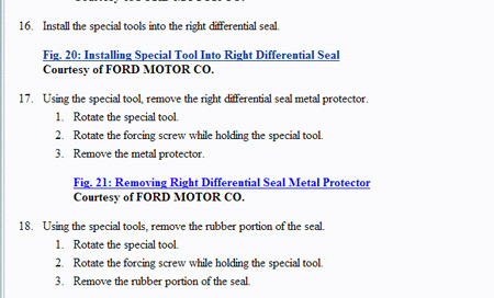

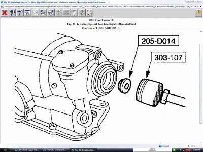

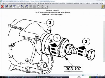

You'll need the tool,as far as I can see, maybe a rental...Metal piece comes out first, then follow these steps...

Removing the seal doesn't need the factory (Rotunda) puller. Just use a KD seal remover or else a long pry bar and or long needle nose pliers. Force the existing unit from the output shaft hole. This takes a little bit of doing and you first may need to dislodge the metal shield with the holes around the circumference. Some times you get the top metal shield off and the rubber inner seal with the garter off but not the remaining part of the seal and it will look reall snarley. Continue to force the remaining part of the metal backing of the old seal out of the hole until you have the smooth round surface of the transaxale case present. You should have tranny fluid leaking so use a pan to catch it.
Then you have to install the new seal. You can buy a seal installer from Lisle for anywhere from $65 to $90 or you can simply get a large socket wrench 1 1/4 or larger to fit over the new fluid seal. Attach a long socket extension to the socket and get a hammer. Position the seal in the whole put the socket with extension over and hit the extension with the hammer until the seal is in place. You'll know when it is installed properly when you don't have any more fluid leaking from the lower part of the seal.

Actually got really mad at the thing. Mad enough to get the Ford tools. I know, they are too expensive. On the other hand even with that I still probably saved some $$ doing it mayself. The Ford tool ripped the outer part of the seal off in about 3 seconds. The innerr part was a bit damaged (by me) and the tool had some trouble with it. That I managed to start with the Rotunda thing and then stuck a slide hammer on it. Ok, so that part took about 30 seconds. Nice when you have everything you need:)
