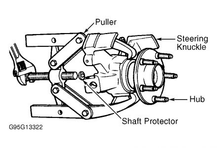

I am trying to find a diagram of the right front hub assembly. My sister can not afford a mechanic. I am pretty sure that I know how to replace the hub. I want to be sure I go into this job knowing what I am doing. If I could some way get a diagram or step by step procedure I would really be grateful.

Slide knuckle assembly off strut. Remove wire, and place knuckle assembly on bench. Remove hub from knuckle using Front Hub Puller (D80L-1002-L) and Shaft Protector (D80L-625-1). See Fig. 2 . Ensure shaft protector clears bearing I.D. and is centered.

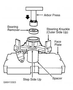

Remove bearing snap ring from knuckle. Using hydraulic press, install appropriate bearing spacer (step side up) onto press face plate. See Fig. 3 . Put steering knuckle (outboard side up) onto spacer. Install appropriate bearing remover on bearing inner race, press out bearing and discard.

Fig. 2: Removing Hub From Knuckle
Courtesy of FORD MOTOR CO.
Fig. 3: Removing Hub Bearing From Knuckle

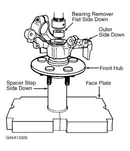

Place appropriate bearing spacer on arbor press plate, and position hub onto spacer, with lugs facing down. See Fig. 6 . Position knuckle assembly onto hub barrel, with outboard side down. Position appropriate bearing remover onto inner race of bearing, and press until bearing is seated onto hub. Ensure hub rotates freely on hub in knuckle after installation.

You will probably find out it was the cv halfshaft instead of hub. So replace cv halfshaft while you have it apart.$59/95 at o'reilly auto parts. Hub about $49.95
