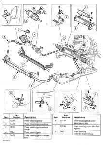

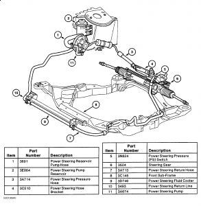

where is the rack and pinion on a 2001 ford taurus?
