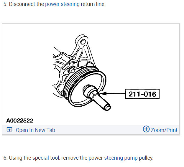

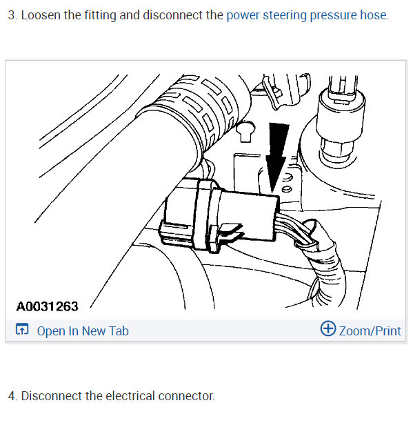

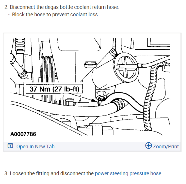

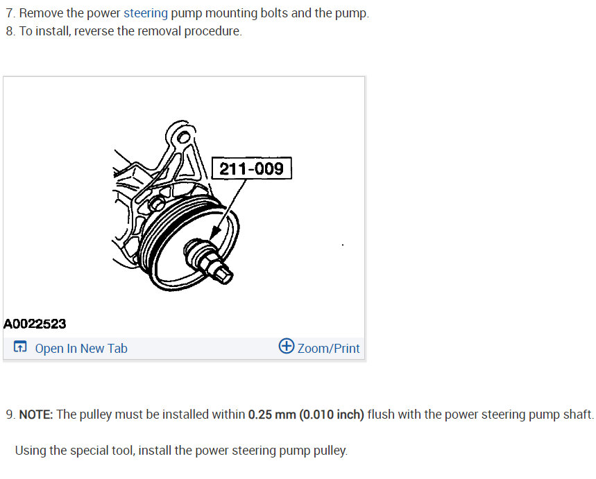

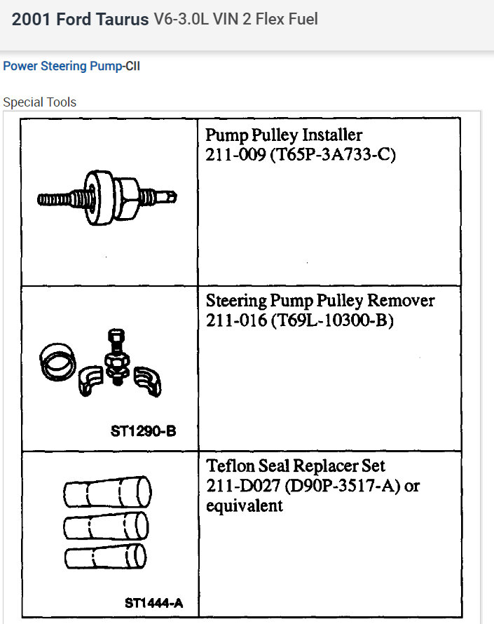

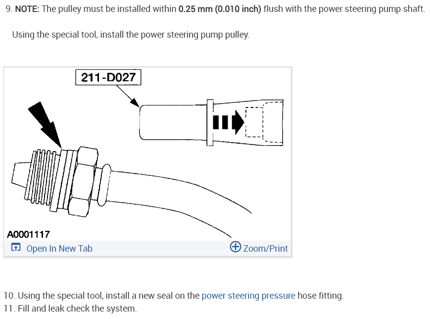

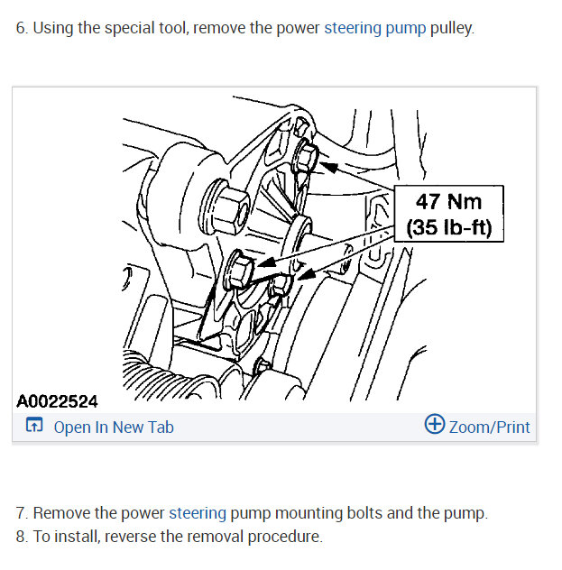

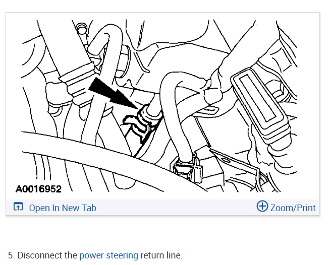

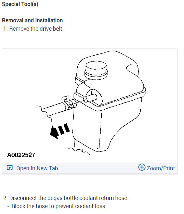

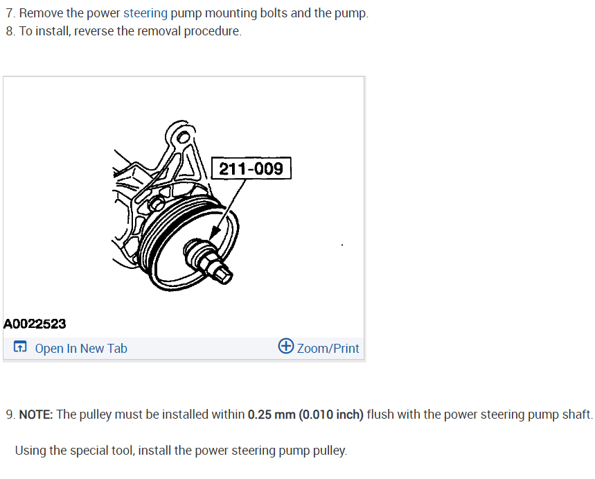

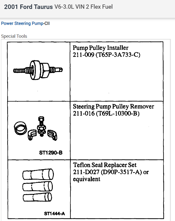

If the engine is running and you remove the lid to the pump you should be able to see fluid circulating and if not the pump is bad. Here is how to change it out to help fix the problem.
Check out the images (below). Please upload pictures or videos in your response of any problems so we can see what to help you with.
