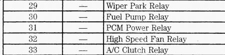

Hello. The 30 amp pcm relay fuse under the hood blew the other day leaving my wife stranded. I tried replacing it back it pops immediately after you turn the key to run. I am trying to figure out where to start tracking a short. There was a remote starter installed on this car a few years ago, but my understanding is the pcm circuit is not affected by this wiring. We also had the heater core replaced this past summer. Is it possible a wire could have gotten pinched and has now rubbed through. I thought about unplugging the pcm module and testing. If it still shorts then I know it's something else. What else is on this circuit.

Nothing else is on that fuse..change the relay in spot 31, that's the PCM power relay.
https://images.2carpros.com/forum/automotive_pictures/62217_relays_2.jpg
https://images.2carpros.com/forum/automotive_pictures/62217_PCM_Relay_1.jpg

ok. replaced the relay and nothing different. Fuse blows instantly. It doesn't if the relay is out. Any other ideas?

Pull that power distribution box and check for any sign of burnt or melted wires, if non found, remove negative battery cable, unplug the PCM, re attach battery cable and see if it blows with PCM out of the circuit, it may actually need a new one! Check wire colors at PDC and trace for shot at PCM connector.
