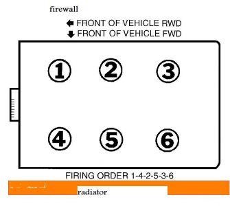

Can you tell me the numer 1 cylinder for 3.0 VIN U Ford Taurus

https://images.2carpros.com/forum/automotive_pictures/99387_taurus_1_2.jpg
