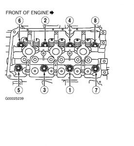

Is there a site that will give me the pattern and amount of torque for head bolts after replacing a head gasket

Step 1 30 step 2 66 step 3 loosen bolts 360 degrees step 4 30 step 5 tighten additional 90 degree step 6 additional 90 degree
https://images.2carpros.com/forum/automotive_pictures/99387_ford_taus_1.jpg
