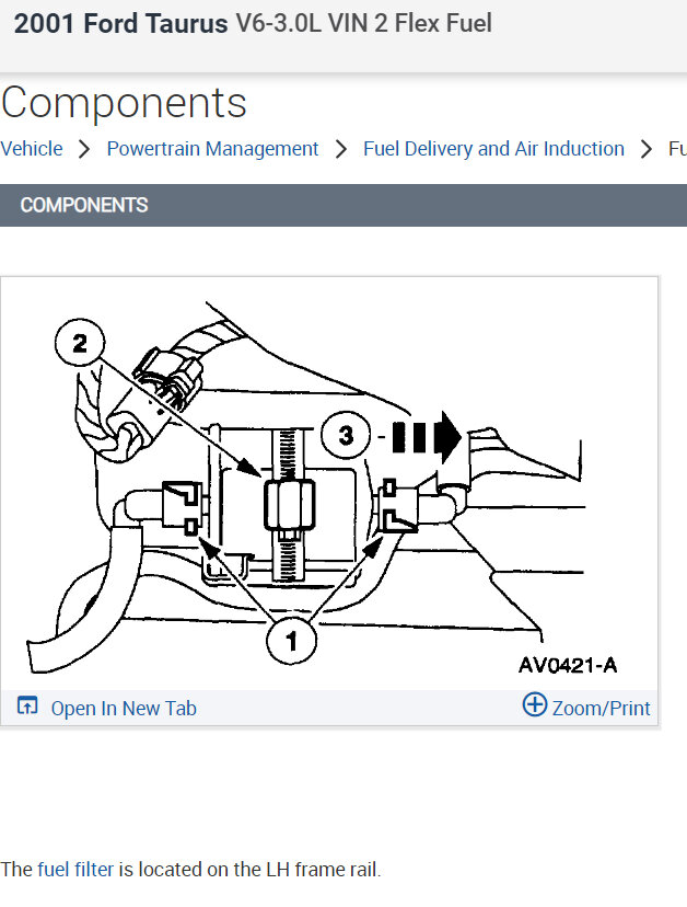

Where is the fuel filter on this car located?

I believe the fuel filter is located in front of the fuel tank and on the passenger side of the vehicle.

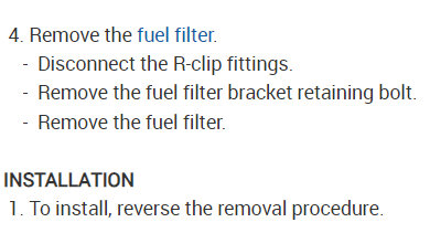

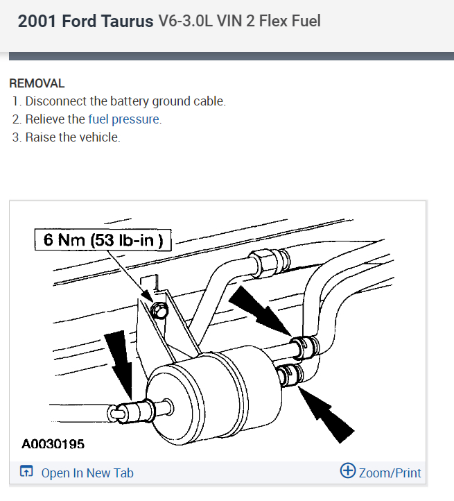

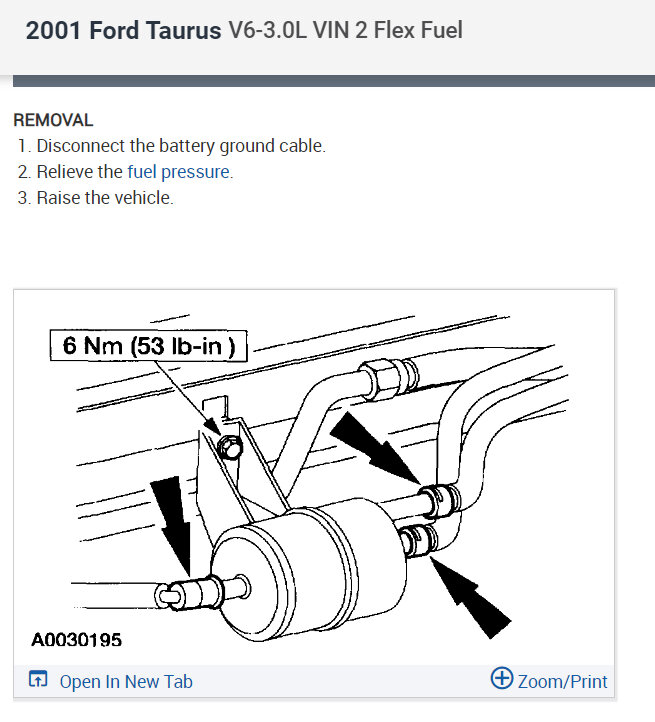

Dec 14, 2007 at 2:48 PM
  • 55,721 POSTS
The fuel filter is located on the LH frame rail. Here is a video that can help you change it with instructions in the images below to help you further. It is not the same car but it shows how to undo the fuel lines which you need a special tool for.
https://www.youtube.com/watch?v=U0XdsQkq-b4
Check out the images (below). Let us know if you need anything else.
