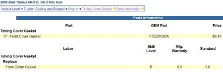

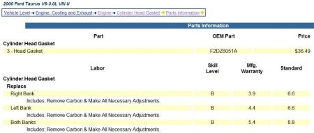

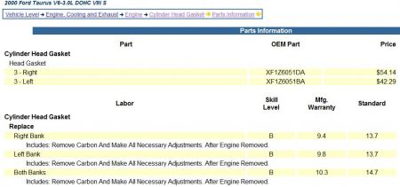

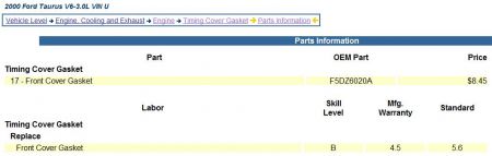

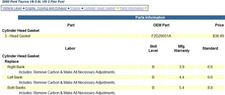

Hello, I've taken my Taurus into the shop because I noticed a severe leak in my coolant system. They told me that it's a leak and that they need to replace the head gasket. Total cost of that was quoted at $1900. Now they are replacing the head gasket and tell me that the main problem is the front timing cover gasket and will cost me up to $1100 dollars more for parts and labor which brings my initial 1900 to 3K. Is thing a fair price? Or did I just get ripped off?
Sep 14, 2010 at 7:16 AM
  • 75,988 POSTS
If you haven't sign the paper works don't do it-otherwise you have been had.See below: 2000 Ford Taurus V6-3.0L VIN U
https://images.2carpros.com/forum/automotive_pictures/12900_cg_1.jpg
https://images.2carpros.com/forum/automotive_pictures/12900_hg_8.jpg
2000 Ford Taurus V6-3.0L DOHC VIN S
https://images.2carpros.com/forum/automotive_pictures/12900_cg_2.jpg
https://images.2carpros.com/forum/automotive_pictures/12900_hg_9.jpg
2000 Ford Taurus V6-3.0L VIN 2 Flex Fuel
https://images.2carpros.com/forum/automotive_pictures/12900_cg_3.jpg
https://images.2carpros.com/forum/automotive_pictures/12900_hg_10.jpg
Note:Part and labor varies within location.
