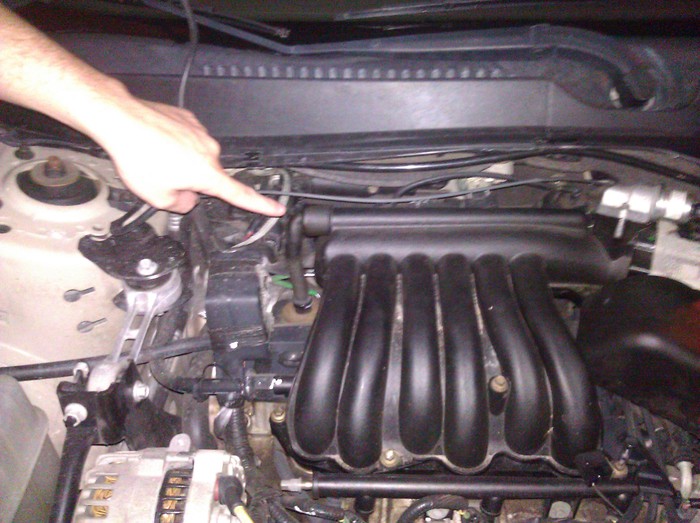

Can't find the PCV valve ?? What would be the next step ??

I also had my car stalling out multiple times at red lights and just at idle.., well they told me to change O2 sensors, the fuel injectors, fuel filter, the fuel pump and hope the problem would be fixed. I found out what it was...., at O'reilly auto parts it is a $12.00 dollar part but they have to order it. It was the PCV valve elbow connected to the intake manifold.
