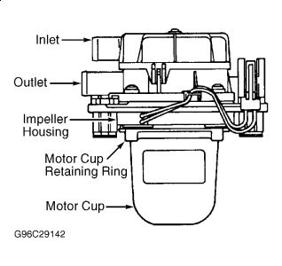

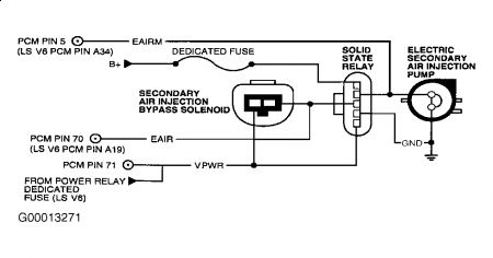

Wiring harness circuits (B+, EAIR, EAIR monitor and ground).
Solid State Relay (SSR).
Electric Air Pump (EAP).
Air injection by-pass solenoid.
Air injection diverter solenoid.
Air injection diverter valve.
Powertrain Control Module (PCM).
https://www.2carpros.com/forum/automotive_pictures/99387_Graphic1_429.jpg
https://www.2carpros.com/forum/automotive_pictures/99387_Graphic2_214.jpg
