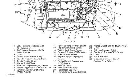

1998 Ford Taurus Two Wheel Drive Automatic
I got a DTC code of P1413 and I cannot seem to find some parts that I need to check for troubleshooting it. The Solid State Relay and the dedicated fuse to the air pump. Pictures would help allot. Also any thoughts on the most common part failure. I did put 12v to the pump and it spun so I think the pump is ok. Thanks.

https://images.2carpros.com/forum/automotive_pictures/139033_relay_2.jpg
