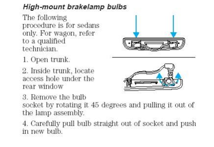

I have the 1999 ford taurus wagon. The top mounted brake light need lamp replacement. How do I do this as I am unable to remove the lens or reach the lamp sockets.

Hi, found this procedure for sedan.
https://images.2carpros.com/forum/automotive_pictures/170934_ford_highmount_bulb_1.jpg
