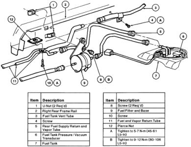

Can you show me how to change the fuel filter on my 1999 Taurus Se Wagon? I have located the inline filter but if you have a diagram or pictures with instructions, that would be a big help to me, as I have never worked with an inline filter system before, and I am not a mechanic. I'm just trying to save some money by doing some of the maintenance myself. Thank you so much!

The fuel filter is located at the RH rear frame rail adjacent to the RH front corner of the fuel tank.
REMOVAL

1.Perform Fuel System Pressure Relief procedure.
2.Remove push connect fittings at both ends of fuel filter and base.
3.Remove fuel filter and base from bracket by loosening mounting clamp enough to allow fuel filter and base to pass through.
INSTALLATION
1.Install fuel filter and base in bracket, ensuring proper direction of flow as noted earlier. Locate fuel filter and base against tab at lower end of bracket. NOTE: The flow direction arrow should be positioned forward and downward to ensure proper flow of fuel through replacement fuel filter and base.
2.Install push connect fittings at both ends of fuel filter and base.
3.Tighten mounting clamp to 1.7-2.8 N.m (15-24 Lb-In) .
4.Start engine and inspect for leaks.
