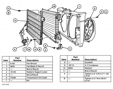

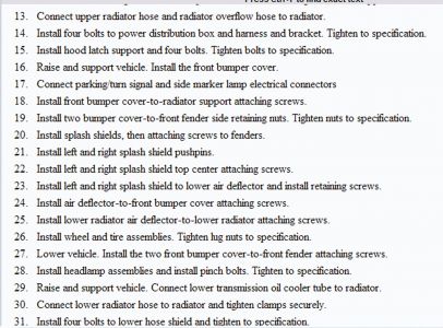

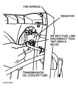

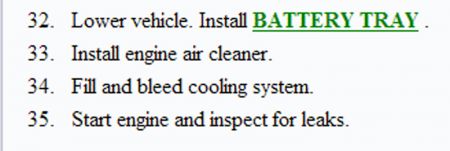

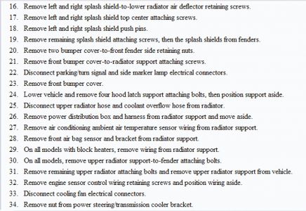

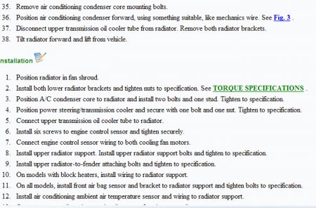

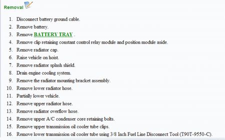

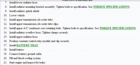

How do you remove the radiator from a 1999 ford taurus-se.
Sunday, May 25th, 2008 AT 12:56 AM
MERLIN2021
MECHANIC
17,250 POSTS
SPONSORED LINKS
Sunday, May 25th, 2008 AT 7:30 AM
