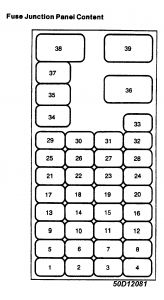

where and which fuse needs to be replaced for windshield wipers and the lighter
Dec 4, 2008 at 7:18 PM
ZACKMAN
  • 4,202 POSTS
Wiper: Fuse #17 30A under left side dash, 2 wiper relays inside relay control box, under hood near battery Cigarette lighter: Fuse #20 5A and fuse #21 20A under left side dash
