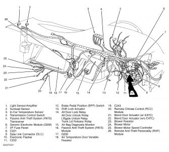

check the Electronic Flasher.....Under left side of dash.
https://images.2carpros.com/forum/automotive_pictures/266999_flash_1.jpg
