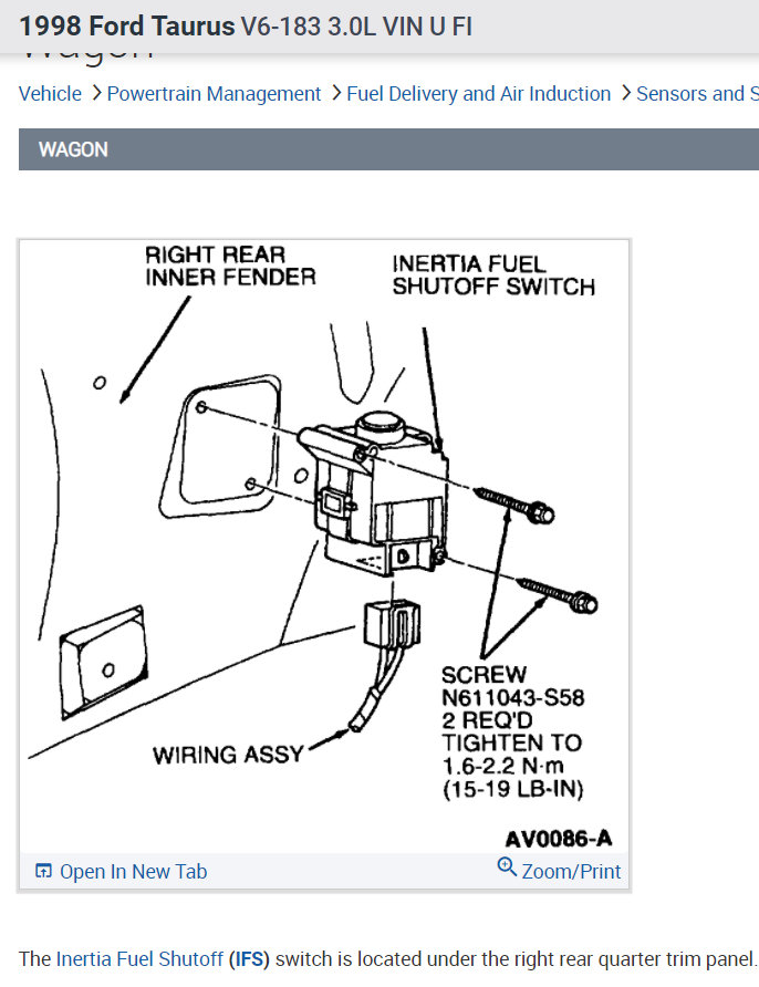

Where is the reset button located at on the 1998 Ford Taurus?
Mar 10, 2007 at 5:28 PM
TAURUSWHEEL
  • 718 POSTS
Fuel pump reset??? Usually on the right side rear, behind a panel in the trunk, or small access door in wagon.. button will be on top of fuel relay. Check out the diagrams (Below). Please let us know if you need anything else to get the problem fixed.
