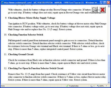

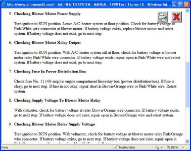

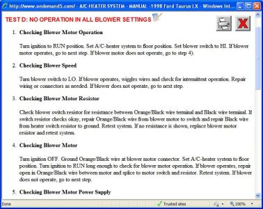

My blower motor works when it wants too. When it comes on, all speeds work fine. I checked the motor itself, and it works fine. i took out the resistor and it is very rusty. i think that is the problem but not sure. is there a way to test this part?

Give that a try when the blower motor doesn't work at all.
