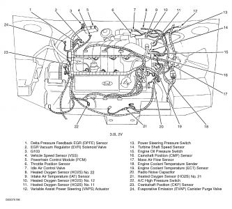

Where is the connection for the oil pump? The pressure switch is working letting me know theres no pressure and it happened after I changed the upper intake gasket so I must have unhooked something and plugged it into the wrong place or didnt plug it back in can someone help with a diagram or a picture

Are you refering to the oil sending unit? If so, is located on the rear of the engine block on top. Here is a picture. It is number 15 on the picture. You may need to enlarge the picture to see it.
https://www.2carpros.com/forum/automotive_pictures/249084_5_79.jpg
Let me know if this helps.
