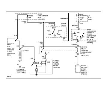

I want to install a neutral safrty switch myself, how should go about it? Are there any special tools necessary or is beyond a novice's ability? Also there a problem with the oxy. sensor I want to put it in also

Hi: Here is a schematic of the starting system. The switch you are refering to is refered to as a transmission range (TR) switch. I's located in the left rear of the engine compartment on top of the trans housing.
https://images.2carpros.com/forum/automotive_pictures/249084_sensor_1.jpg
As far as the O2 sensor, you can check it if you have a multi meter. Here are the directions: http://www.2carpros.com/how_to/how_to_test_oxygen_sensor.htm Let me know if this helps, or if you have other questions. Joe
