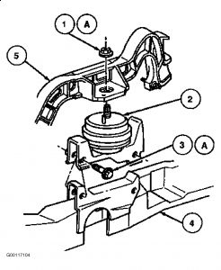

Gotta replacel it, and find that the bolt on the front bushing has been installed from the top.
I can't get the bolt all the way out, as there is a cast member above it.
what's the best/easiest way to move which parts to access this bolt?

Ok you will need to remove the trans mount and lower that a little. Here is a pic. I hope this helps

The answers I'm getting make it clear most of the parts guys I'm talking to don't have a clue. 4 different sizes so far when I ask, i.E. Different dealer, different bolt size. :(
Looking at the car/pic, I need to lower #4 to get the clearance.
Remove #1, then release the front/rear bushing on #4, then lower the subframe(#4)?

Lowering number 4 is correct. As for the bolt sizes they just don't catalog that stuff I do wish they would as it would be so much easier but imagine the size of the repair manual if they did. All I could suggest is that if you are missing any of those bolts is go to a salvage or wrecking yard and buy them there.
