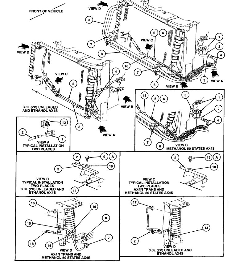

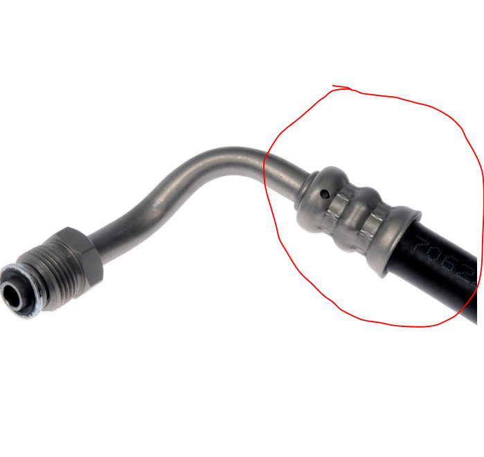

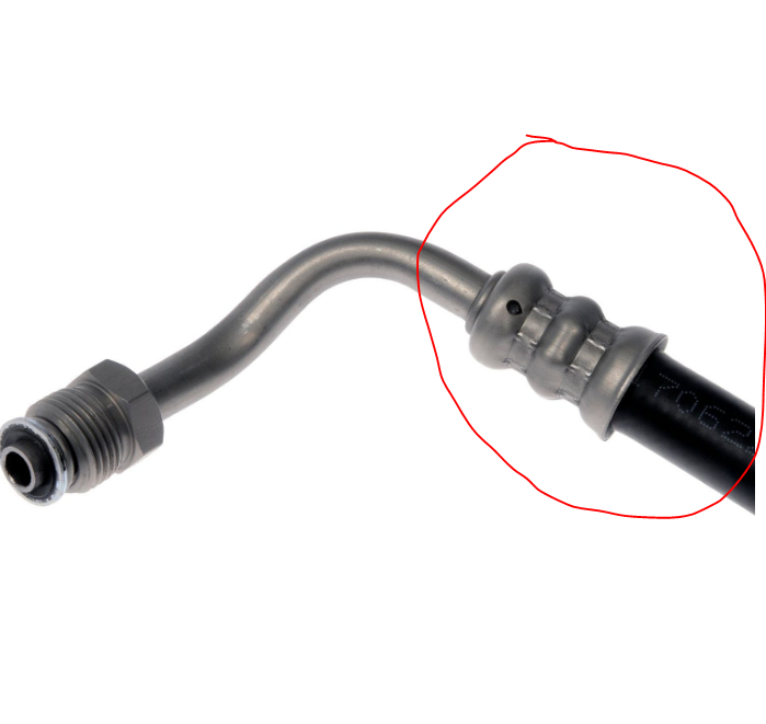

My car is leaking transmission fluid from one of the lines. The leak is below the battery area. It's coming from the top line at the connector. Can I just replace the connector or is the line one piece?

Those cooler lines typically have hydraulic fittings and connectors. If you get a leak the whole line needs to be replaced.
