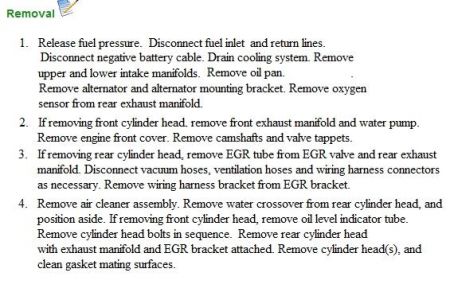

I have oil in my anti freeze - possible head gasket leak. How do I repair this and what are the torque specs etc
