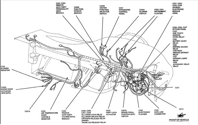

Blinker and emergency flasher not working?
Apr 8, 2009 at 6:48 AM
  • 55,399 POSTS

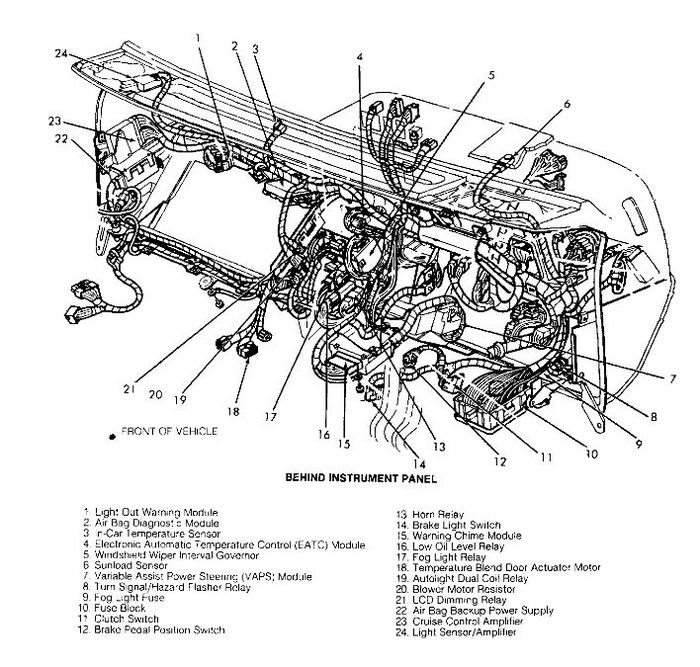

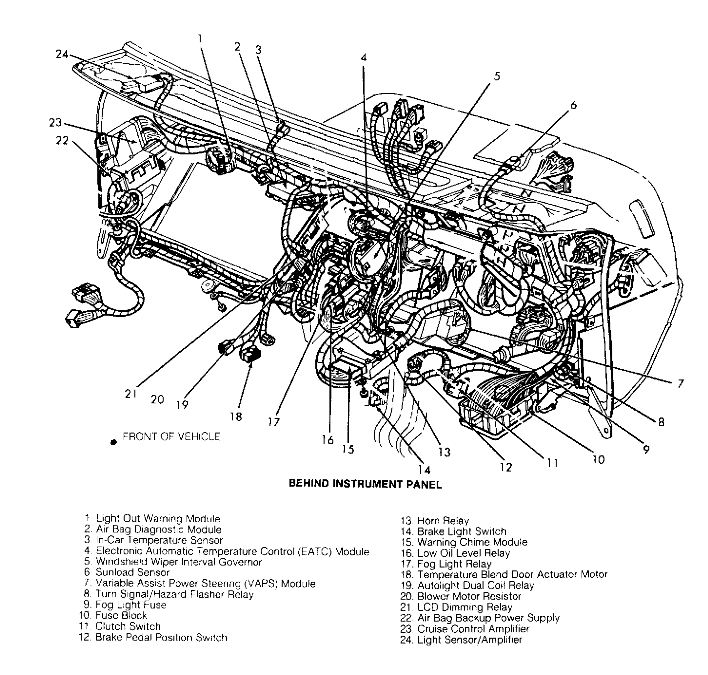

The turn signal flasher is under the dash on the drivers side. Here is a guide that can help with the problem check out the diagrams below for the location.
https://www.2carpros.com/articles/turn-signals-not-working-blinker
Check out the diagrams (Below) Please let us know if you need anything else to get the problem fixed.
Feb 19, 2018 at 6:30 AM
DRCRANKNWRENCH
  • 3,380 POSTS

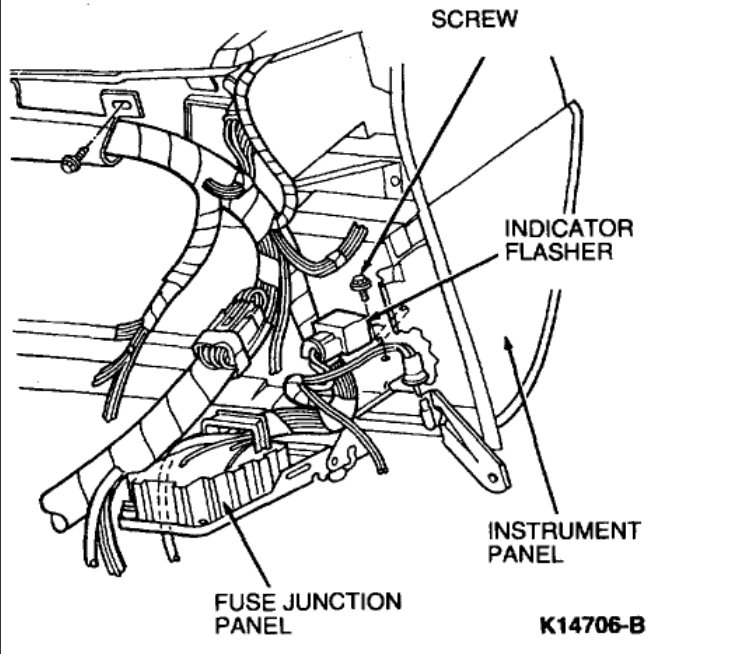

It is located behind left end of instrument panel above the fuse box. See attached diagram.
Feb 19, 2018 at 6:32 AM (Merged)
93SHO
The blinkers in my 1993 SHO Taurus have gone out same with the hazard lights, the fuses are fine, it's a 3.2 liter, with approx 160k miles. Where is the flasher, because I am sure that is the problem.
2CARPRO JACK
  • 11,533 POSTS
Behind left side of dash above fuse block
