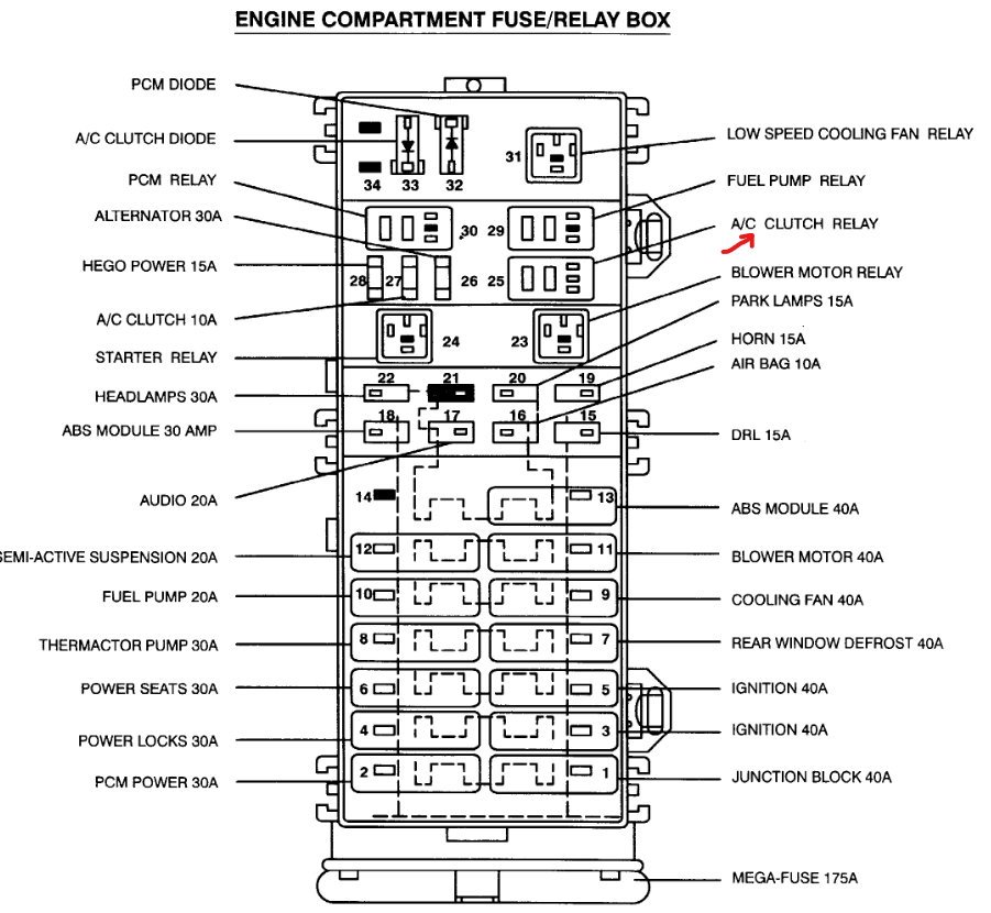

new battery something drains it overnight?
1998 FORD TAURUS
135,000 MILES • 6 CYL • 2WD • AUTOMATIC
TIGGER41
had all fuses and sensors check had alternator check and my powered windows all four will not worked bought a new battery something drains it overnight some think its a shortage in my wiring in steering column
Dec 14, 2007 at 11:34 AM
FLEXY5
  • 512 POSTS
Parasitic power drains usually happen because of module failures. If it was a short in the system, you would have blown fuses. The other possibility is the power window relay which may be stuck.
Dec 14, 2007 at 2:57 PM
  • 55,433 POSTS
The windows dont work when the key is off so that will not cause the problem. I have seen the AC clutch control relay stick on and cause this issue, here is a guide to help and the relay location so you can remove it to see if the problem goes away.
https://www.2carpros.com/articles/car-battery-dead-overnight
Here is the AC clutch relay location marked in red. Check out the images (below). Please let us know what happens.
