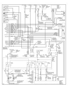

My brother in law has no heat because the blower motor is not coming on. The blower motor, resister, and relay have been replaced. Both fuses have been checked. There is no power to the blower motor. If both fuses are in ok shape, how can I figure out why there is no power to the blower motor? I dont believe there is any bower to the resistor or switch either.

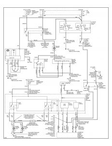

Place the heater switch on high
use a test light and check for power and ground at the motor
if no power check fuses and wiring
if u have manual system check PNK/WHT wire
check relay
if you have an auto system check blower
http://www.2carpros.com/forum/automotive_pictures/99387_Graphic1_28.jpg
http://www.2carpros.com/forum/automotive_pictures/99387_Graphic2_20.jpg

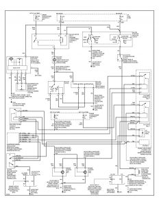

Check u r e mail
also check this
Fuse # 11, 40A in engine compartment (hot at all time ) BRN/ORN
fuse # 13, 5A PPL/ORG and fuse # 6, 15A YEL both inside the car fuse panel
blower motor relay is located in engine compartment fuse/relay box
PNK/WHT wire runs from the relay (under the hood ) to the blower motor (inside under the glove box)
+1
Monday, November 3rd, 2008 AT 4:51 PM
BMRFIXIT
  • 19,053 POSTS
I will try to email it again
did u check the above things
http://www.2carpros.com/forum/automotive_pictures/99387_ford_4.jpg
