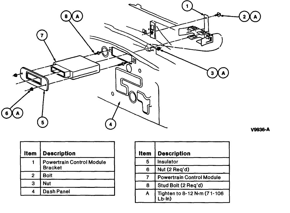

I think i've damaged the ecm while replacing the alt. I had a bad short because I didn't disconnect the battery, is the ecm located behind the glove box in this taurus gl. Wagon

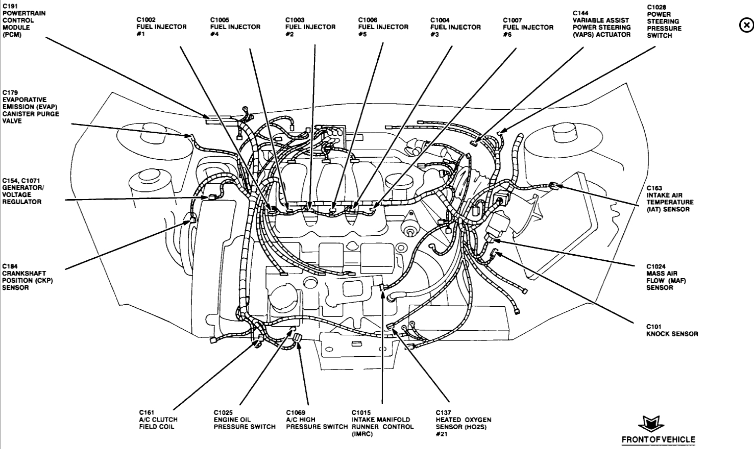

The ECM is located in the passenger's compartment above the hvac box which you can get to by removing the glove box door. Here is some diagrams (Below) so you can see what I am talking about.

It passes through the firewall on the passenger side and is accessed from the engine side but most of it hangs inside under the dash.

Powertrain Control Module (PCM) On top right side of firewall.

If it is a 3.0L engine it is mounted on the side of the distributor.
If it is the 3.8L engine it is located on the passenger side firewall.
