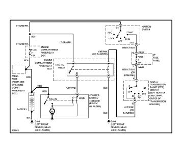

On my girlfriends car, the starter wont turn off after I try to start it. I have to turn the ignition off and then disconnect the battery. I replaced the ignition switch (didnt work) so I took out the starter and brought it to schucks (it passed). Any ideas what it can be. THANKS!

https://www.2carpros.com/forum/automotive_pictures/99387_Graphic1_33.jpg
Check starter relay in engine compartment fuse relay box
