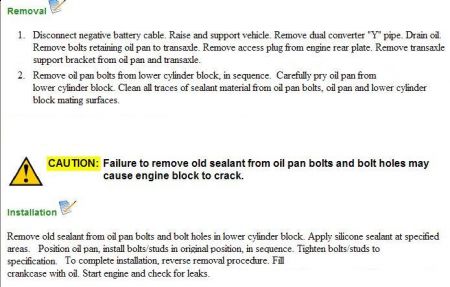

I wanted to know the best way to replace the oil pan gasket. The down y-pipe seems like it would be a pain to remove, especially since the bolts to the rear manifold are hard to get to and rusty too. The front bolts to the front manifold are easy to get to! What should I do? My oil pan gasket is leaking bad with gasket sticking out!
