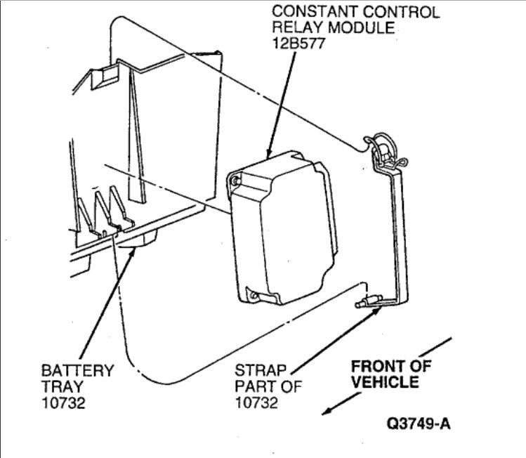

Can anyone help me find the fuel pump relay in my car? According to the Chilton's electrical diagram of the car there is one on it, but they fail to mention anything regarding its location. Is the fuel pump relay perhaps inside of the control module?
I have checked the inertia switch, verified gas is not going to the engine by removing the line before the gas filter, replaced the pump to my dismay, and made sure the fuse not broke. I have also checked the fuse box underneath the steering wheel, underneath the hold, and also checked underneath the driver's seat with no luck.

The fuel pump relay is incorporated in the constant control relay module located next to the battery. I would recommend spending the extra money and purchasing it from the dealer instead of the local auto parts store as I learned the hard way.
HEre are some guides to help you test it.
and
Here is its location (below)

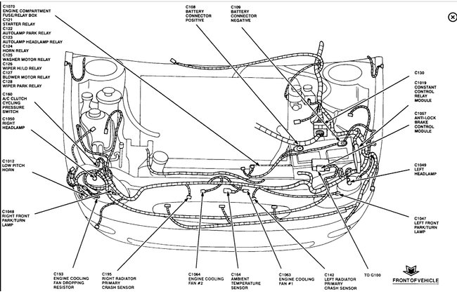

I have dicovered that I must replace my Fuel Pump Relay or Regulator but I cannot find where its at. I have an general idea of where it is located which is to the left of the battery somewhere on or around the radiator guard. Please assist me with finding the location of this part because my car is unable to run without it.

Hi mr.smith_5, Welcome to 2carpros and TY for the donation Dunno what liter engine but am using a 3.0 liter-the fuel pump relay is integrated with the constant control relay module-see below for location
https://images.2carpros.com/forum/automotive_pictures/12900_ccrm_1.gif
Disconnect battery ground cable, then remove radiator sight shield. Disconnect electrical connector, then remove module from radiator support. Reverse procedure to install.

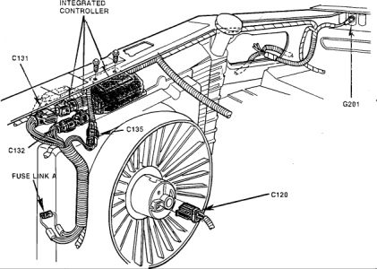

Where is the Fuel Pump Relay Located?

https://images.2carpros.com/forum/automotive_pictures/12900_fprf_2.jpg
The Fuel Pump Relay is part of the Integrated Control Relay Module, is located at the front of the engine compartment, on the upper radiator support. https://www.2carpros.com/kpages/auto_repair_manuals_alldata.htm

On earlier Taurus, the ccrm was originally called the integrated controller module, not sure when they changed names
