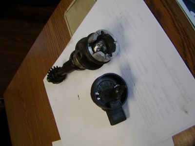

1997 Ford Taurus fault code p0340
133,000 MILES • 6 CYL • FWD • AUTOMATIC
ISM0624
went through emissions and code p0340 came up.
ive already changed camshaft position sensor. wondering what else could be wrong.
Thank You
Mar 4, 2008 at 9:39 AM
SERVICE WRITER
  • 9,123 POSTS
Underneath the camshaft position sensor is the camshaft sychronizer. That almost always needs replacement with that code on Fords, from what I've seen.
