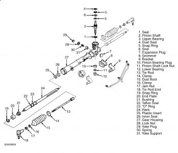

1996 Ford Taurus Inner Tie Rod Replacement
JASONBARRYJANISE
Steering problem
1996 Ford Taurus 6 cyl Front Wheel Drive Automatic
Could someone give me a step by step on how to change an inner tie rod for a 1996 ford taurus, please?

Jack and secure car remove tire loosen jam nuts on outer ends of tie rods. Remove jam nuts and outer tie rod ends. Remove clamps which retain boots to gear housing and tie rods. Remove boots and breather tube use a specail tool and remove inner tie rod end
https://images.2carpros.com/forum/automotive_pictures/99387_Graphic1_323.jpg
