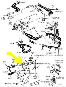

Earlier you had said that there is no special fill procedure but I know removing the thermostat is the way to get maximum flow in the system. Good point. What am I doing by filling until coolant arrives at the thermostat?
I am curious of the 'expansion tanks' for lack of better term at the bottom corners of the radiator. Can you point me to something that shows this cooling system in schematic? So many hoses!
Feb 24, 2010 at 3:43 AM
BMRFIXIT
  • 19,053 POSTS
The side plastic tank is part of the system and it is pressurized
https://images.2carpros.com/forum/automotive_pictures/99387_Capture1_3.jpg
