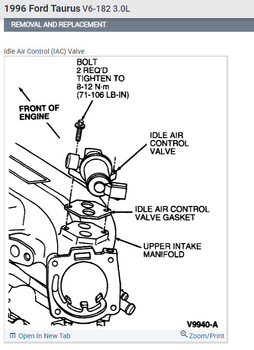

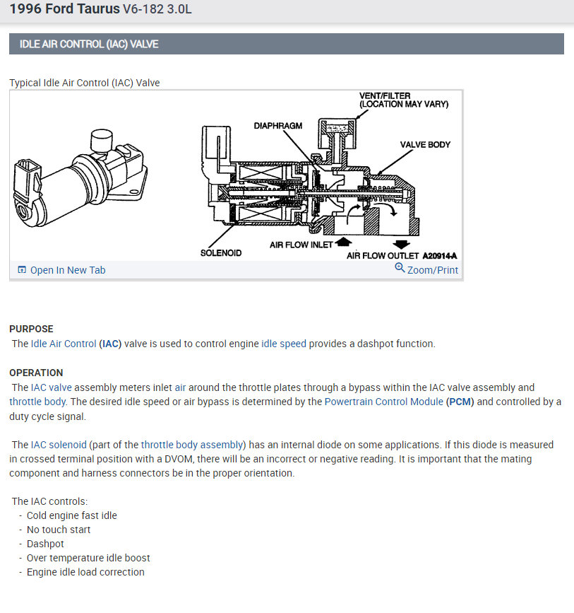

It sounds like you might have an issue with the idle air control valve (IAC).
The IAC is located on the side of the throttle body.
Many times a dirty IAC will trigger an issue with the idle quality.
As air travels thru the IAC the larger air particles get stuck to the inside of the valve. Overtime it will have enough buildup to impact the idle.

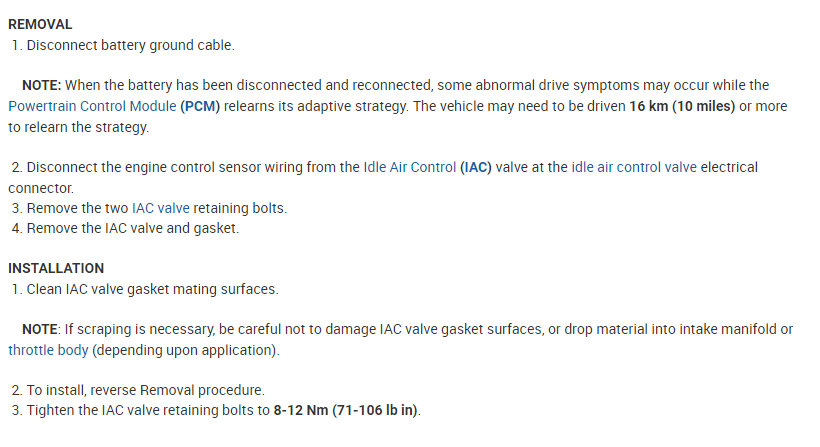

You might be able to service the IAC by cleaning it out. Typically that will fix the issue.
https://www.2carpros.com/articles/how-a-idle-air-control-valve-works
https://www.2carpros.com/articles/idle-air-control-valve-service
https://www.2carpros.com/articles/how-to-replace-an-idle-speed-control-motor-iac
