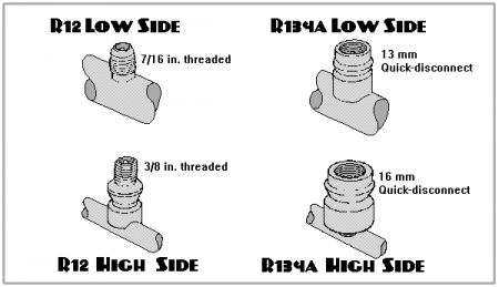

Where is the valve that I hook a can of charger to?

Look for the 13mm fitting within the AC piping see below
https://images.2carpros.com/forum/automotive_pictures/12900_ac_service_fittings_29.jpg
